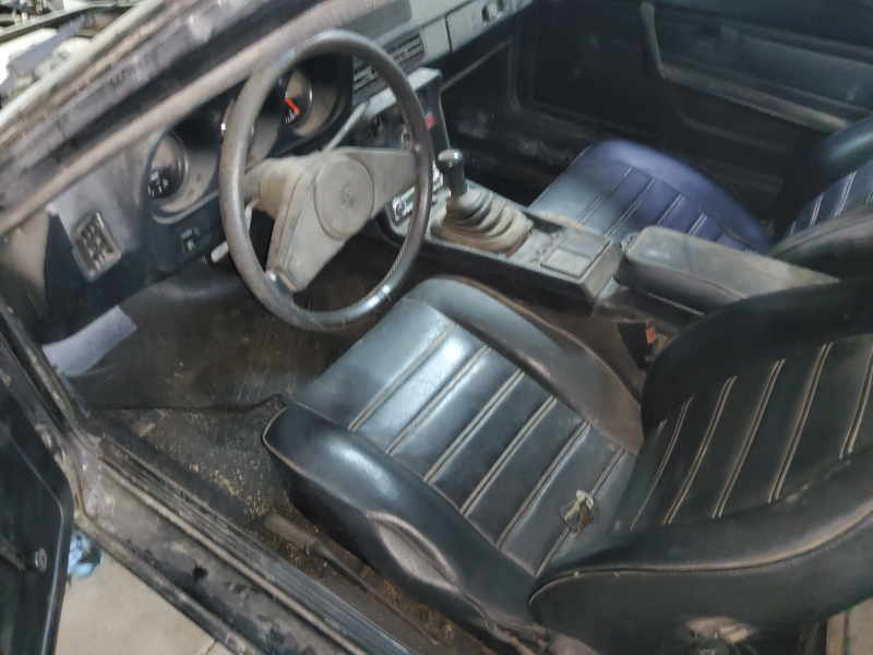

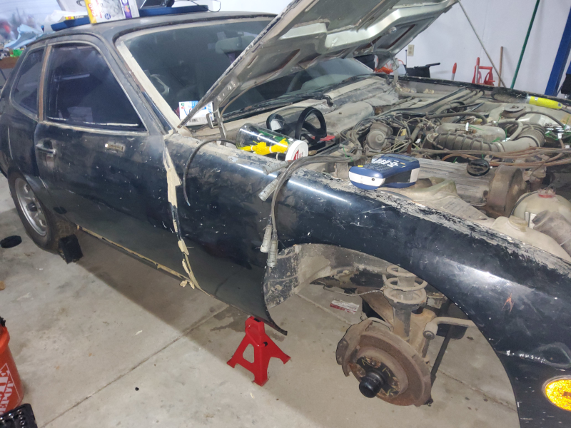

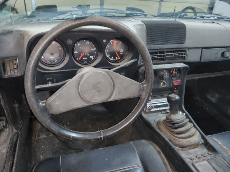

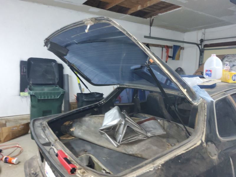

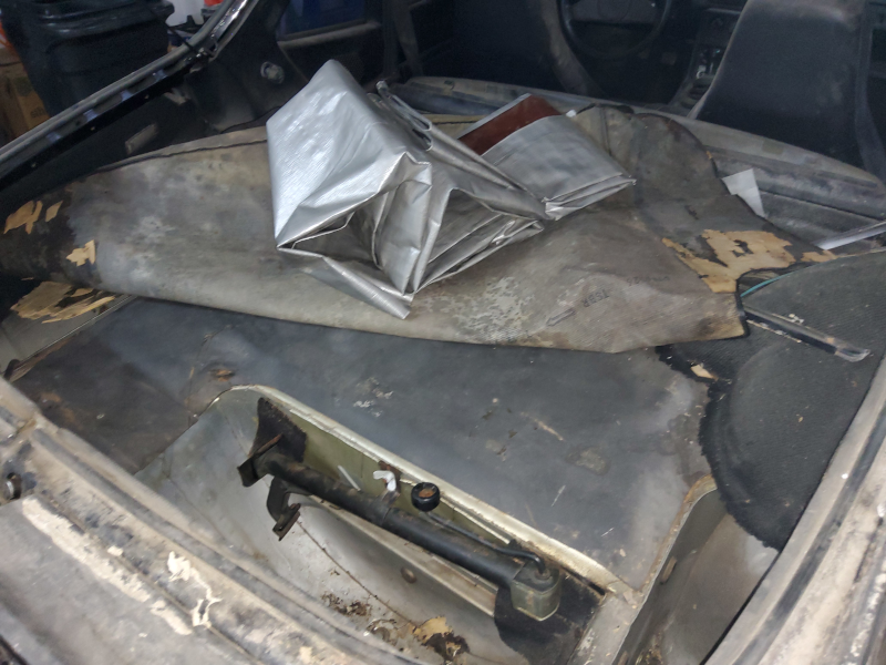

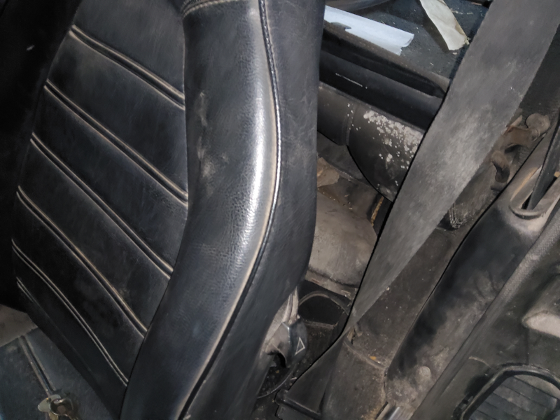

As the top says I bought a 924 originally listed as a 79 but turned out to be a 77 based on the vin and title. I have some question.
One is there a way to tell when it was made? My doors don't have the label so I'm trying to find out if its one of the early 77s ie I'm assuming made in 76 or later 77s given everything I've seen said.

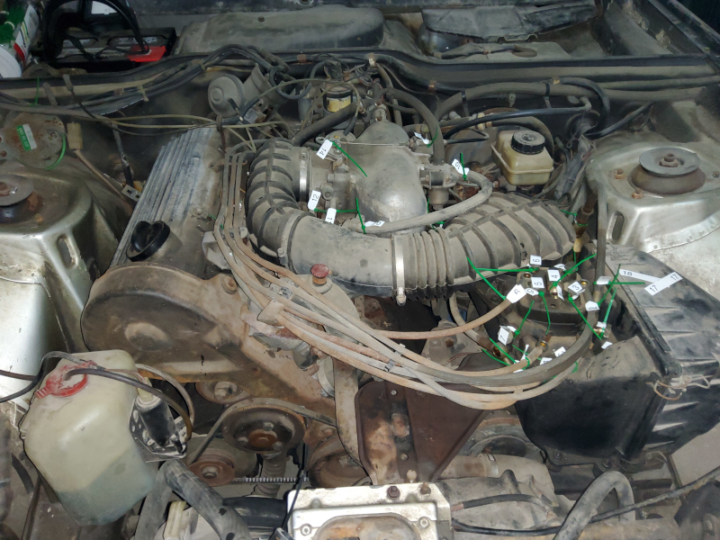

Two when it comes to the engine I've read the 77s crank or I should say the bearings are unobtainium level. I want to keep it stock so if I get a newer block can I use the rest of the parts ie the heads and every thing else or are there other parts off it I can't use on a newer(77 to 82) engine block? Could i use a turbos block and not put on the turbo stuff? I really just want it to be as stock as possible I've never liked modifying cars and like them being stock. My over all plan is if I get the engine fix/replaced to restore it.
My engine is complete trash its a complete lockup I have no movement at all when I put a breaker bar on it and try to turn it. I had an engine sort of lined up pick and pull actually had a 77 924 I spent 4 weeks removing stuff to pull the engine off but last week I went and they had crushed it *rant*I'm still pissed about it like they couldnt check and go oh someones been pulling $500+ in parts off maybe we should keep it around more grrr*rant over lol*
Attached are some photos. Sorry I couldnt figure out to resize to edit the size in the phpbb style

PostPosted: Sun May 03, 2026 8:46 pm    Post subject: Reply with quote
Yeah, a newer block would be fine; could even build and swap in an entire later motor, get the later cam for better performance... throw some higher compression pistons in there to use better octane than the orig 85... probably a header while you're at it, wake the car up nicely.
If it's so stuck as to have the crank locked up, odds aren't great the CIS will work without a lot of effort and cost; might want to think about EFI now and save the time and frustration... Ciprian has a lovely kit for the conversion, would be relatively trivial to put that in as you wrap up the rebuild.

Turbo block is the same.

I have an n/a block in my turbo, the only difference i could find was the crank case breather outlet pointing in a different direction.

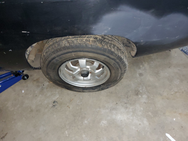

On another note where are the rear spots for jackstands all my googling gives me blurry photos that have me questioning if I should use them.

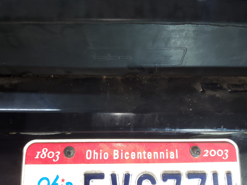

Hey, the Foha spoiler! Nice!

An engine could be dirt cheap depending on how patient you are. Since you'll likely be pulling what you've got anyway, it might be worth tearing down to see what you've got. It's a real nightmare to get all the parts to rebuild one unless you're willing to spend big money on custom pistons and such, but stuff does come across ebay, and you might be able to scrounge up a rebuild rather than having to make a long drive or pay several hundred to have something shipped. I'm not sure how much being and early one adds to that though... As for the fuel injection, you might be amazed at how far you can get just cleaning up what you've got. Plan to start with a new fuel pump and filter. Mine's running pretty well after replacing the pump and filter, a fuel distributor (FD) rebuild (that might not have even been necessary if I'd been more careful of what I sprayed in it trying to get the plunger free) and some cleaning and tinkering. I think you have an iron FD though, vs. aluminum, so maybe that's more likely to be trash. K-jet is a remarkably robust system and pretty easy to live with once you get over the learning curve and get it sorted.

No, I agree with getting the later motor... but it can't hurt to open yours up and see if it's rebuildable. Most likely cause would be rings stuck in bores - straightforward to clear up with a re-hone and new rings, maybe punch it out 0.040" over and raise the compression to 9.5:1 if budget allows new pistons.
The other concern would be the crank, if it's OK or if it's locked up down there. If your crank were damaged, a rod popped or something like that, then yeah you're wanting at least a short block. But still better off properly refreshing any donor block with rings and bearings and gaskets, not just dropping it in as is.

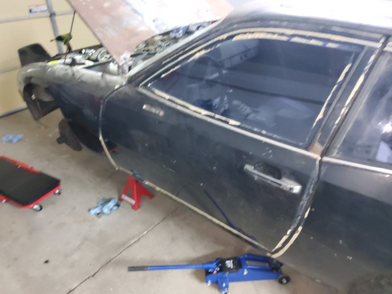

Look, I think you are approaching this the wrong way. I get that you want to have the motor running, but really that's a step further down the track.

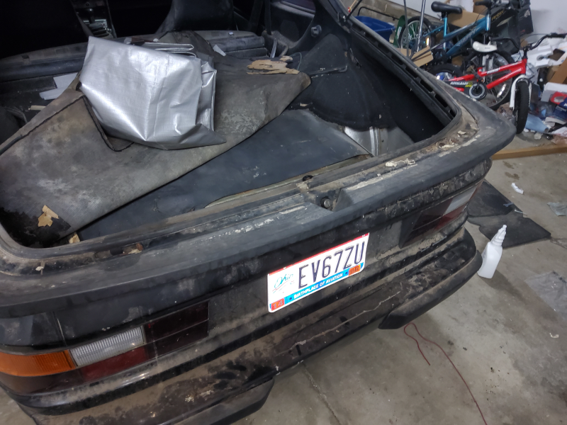

The car has obviously been sealed up with masking tape to prevent the ingress of water/dust. getting that old, hardened tape residue off is a right bitch. Alcohol solvents as used for house painting will help. The interior looks half decent.
First step is to clean the car.....then have a good look at what you have. Are there rust issues? If not then it's worth saving. If so, then EVERYTHING needs to come apart - cleaned/painted/refurbished - and then reassembled.
In the meantime, pour some ATF/power steering fluid down each plug hole/injector hole and let sit. Every few days try turning the motor over. You may be surprised!
If the motor is a dud, then you will need to pull it anyway, however you should disassemble it regardless, to see what happened, and why, and perhaps a repair is feasible.
So far all of this has cost you nothing but time, and you are in a far better situation to decide the next steps.
Just remember to bag and tag everything as you disassemble.

I thought of this and did do some cleaning looks like rats were living under the seat with what i shopvaced out. Im focusing on the engine first since if i cant get it to run theres no point in the rest more so my plan is to get it professionally painted. Theres a dent in the back passenger side corner and some other areas that need work so ill have that fixed as well. My main goal is to have it running reliably before I spend more money on anything else.
