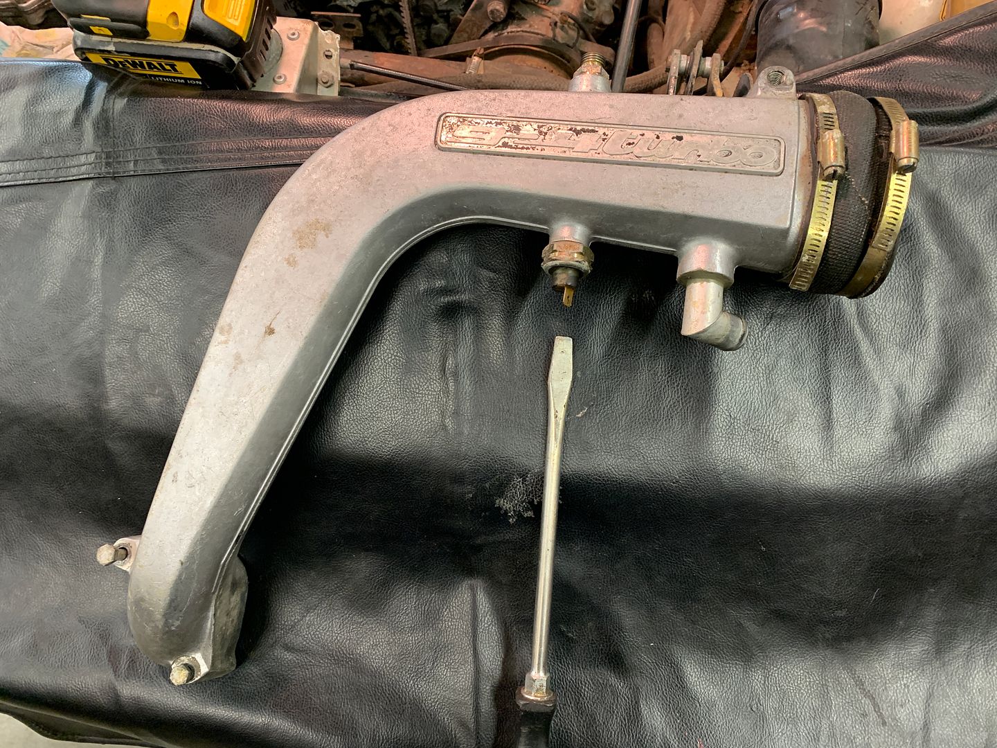

While I am not unfamiliar with Bosch FI systems, this CIS on my 931 is totally new to me.
Wondering what this sensor in the boosted intake plenum is where my screwdriver is pointing? Cannot find in Haynes manual. What does it do? and what should be its resistance cold? I'm getting less than 1 ohm.
JUST FOUND IT ON P. 116 of Haynes manual - the Boost Pressure control switch! Duh!
So what would have been the effect to remove this switch from its circuit?
Or, HOW does it control the boost pressure? Read how to test it - it's just a N.O. pressure switch that makes at 15.6 psi and breaks again at 21 psi. I thought the waste gate controlled boost pressure.......
Thanks!
See note after my pic.....
The PO told me a switch on the console was a secret kill switch - and it appears to have been wired to this sensor to either have it in a circuit or removed from it. Two non-original wires ran from this sensor to the console switch.
Anyone who can point me to an electrical schematic of the sensors in the CIS system, I would greatly appreciate it. I do have original factory manuals but have trouble finding stuff.
TIA,
GN

PostPosted: Mon Dec 06, 2021 11:56 pm    Post subject: Reply with quote
A better name for it might be the overboost switch. When that switch senses an overboost situation, it cuts the power to the fuel pump. The overboost switch is the ground for the fuel pump relay. If the switch is bad, the car does not run. Many will ground the wire running to the overboost switch to eliminate it as a possible cause for the fuel pump not running.
The 1980 924 turbo wiring diagrams are included in the document "Porsche 924 Turbo Assembly and Adjusting Instructions" starting on page 52.
The overboost switch is called the "manifold pressure limiting switch" on the diagram. A brown/white wire runs from the back of the fuel pump relay to the switch. A bad connection and/or bad switch can be the source of trouble.

PostPosted: Tue Dec 07, 2021 11:48 am    Post subject: Reply with quote
THANKS Chuck!
So simple. A fuel-pump emergency cut-off. Pretty fool-proof, but then preventing a blow-up on a turbo-charged engine is hyper-critical.
One more question: Haynes manual says the switch is a N.O. switch, and does not "make" until it sees 15 psi. It stays "made" (closed) from 15 to 21 psi, when it opens again - cutting off the fuel pump.
But how does the intake reach 15 psi without the engine running? If switch is open at less than 15 psi, there is no fuel pressure with which to start the engine.
This obviously is not the case as all good 931's start easily. That would tell me there has to be some bypass switch to provide power to the fuel pump until the 15 psi is in the intake.
Or is the Haynes manual just plain wrong?
Thanks,
GN
Gatornapper
Joined: 23 Oct 2021
Posts: 294
Location: VA
PostPosted: Tue Dec 07, 2021 1:00 pm    Post subject: Reply with quote
I think the Haynes manual is wrong. Switch is N.C. - normally closed - and only opens at 21 psi.
Otherwise car would not start.
Need to go back and re-read the testing section for the switch.....maybe I read it wrong........
