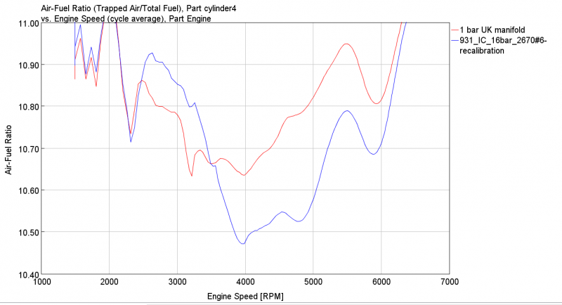

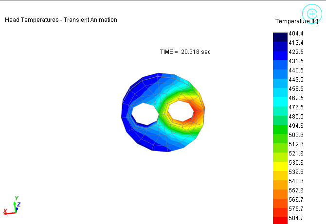

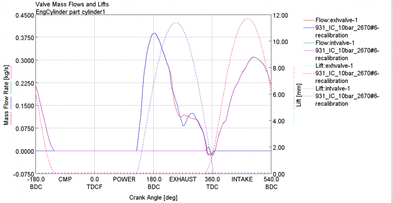

OK guys, heres some nerdy stuff. The software im using is the one used by more or less all OEMs out there. I worked with it for years at my previous job. HOWEVER, since i have so little data, the 931 model is much simpler than the models I used to work with, but anyway still a detailed mode compared to anyhting that has ever been done on a 931 engine.
Heres some nerdy data, i only did one full load transient simulation in this analysis. Its my 8,5CR 2670 s2 engine, timing curve have s2 shape, probably to aggressive for this boost, so that power level would probably not be possible to reach, depending on temperature.

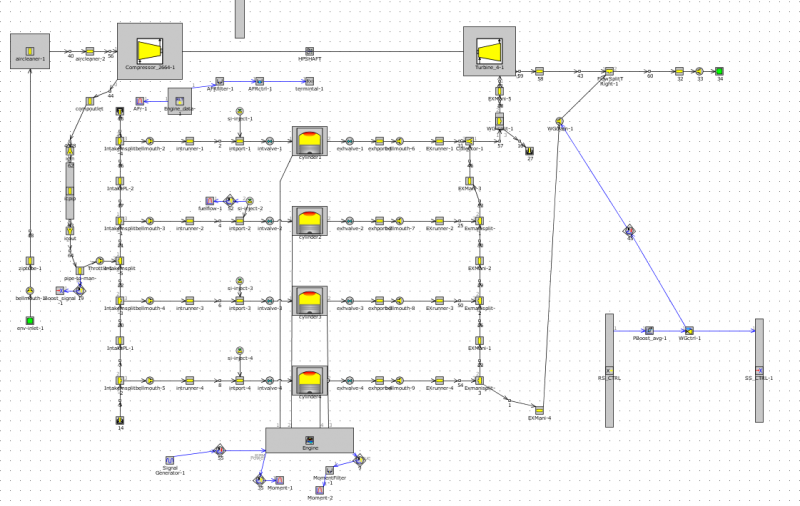

This is how a model looks like, built up by cutting every pipe and part into parts, and the filling them with all sorts of information, maps, heat transfer data, combustion data, etc etc
This is for cylinder four, the one we know might run hotter than the others.
As you can see it runs leaner with the UK manifold, but thats not necessarily a problem, as we can see further on.

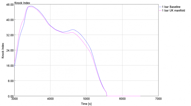

Here you can see the knock index, its very general, since i cant do any detailed predictive combustion simulation due to lack of data. So its more of a general number, the higher the larger the probability of detonation. As you can see, as soon as the boost comes on the UK manifold actually have less risk of detonation, due to the reduced residual gases in cylinder 4 mostly.

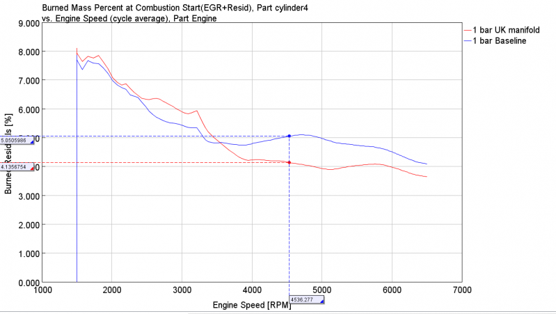

Here you can see the residual exhausts in cylinder 4, more is worse and increase the risk of detonation.

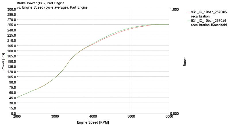

Heres the power, not alot of difference, maybe 3,5 at most. Maybe it could take a tiny bit more timing with the uk manifold on boost, which would make the differens a tiny bit larger.
Everything from combustion to gas exchange is calculated for every fraction of crank angle, so all data is available if you want to get nerdy.
Volumetric efficiency bewteen the runs, its a transient run, so numbers might change compared to a static running points due to heat building up in the material.
[img]https://rejsa.nu/im/user/1552/2020-12-03-20-02-57_voleff.png [/img]
If you are really serious you could also get detailed heat transfer data for valves, cylinders, piston etc,
Conclusion, once its on boost the UK design isnt so bad after all, acually preferable in some areas. Mostly due to the hot cylinder 4 going from the worst when it comes to residual gases (with the std manifold) to being the best (with the uk manifold obviously), and hence the total knock risk goes down a little bit, ad the pumping work is slightly better.

Yes of course, the WG is targeting 1 bar boost, at full power max RPM about 46% of the flow goes through the WG.
Steve, I actually did these probably a year ago, when I had some plans on maybe buying a UK manifold due to the lack of uncracked std manifolds. As you know, 931 parts is something you have to hoard in good time before you need them, if you want to get stuff for a reasonable price
The one i have is repaired by a pro, but after a couple of years there are signs that if maybe wont last forever.
