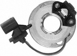

Posted: Thu Aug 29, 2019 2:32 am Post subject: |
updating this thread from my main one
The distributor pickup I ordered turned out to have the wrong connector, we think it is Intermotor part#LX596 that works for a 86 Jetta.
The rest of it matched exactly. Of course it was rebuilt into the distributor so had to order the female plug(443-906-236) from VW, should be here tomorrow. Hopefully this will work.
That is the last piece to get this thing running. The connectors on this pickup are blades, I need a backup connector, anyone know of a squeeze type that would work?
The original plug is NLA, so maybe this is another workaround, although you could just use the spade terminals on the old pickup. I don't know the Porsche part, but this is the VW part.
Still on my car
The VW part
This obscure post Club 80-90 helped me out
So the part from VW does not include any metal connectors, I imagine you could remove from the old connector, but I just ordered the bloody wires too.
That part# is 000979133EA. If you have a cracked housing, I imagine you could use these to attached to the dizzy, or make your own of course.
