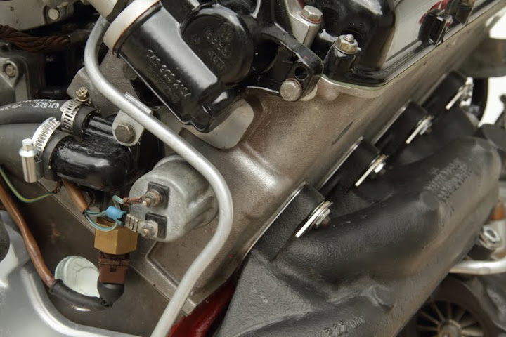

The TTS (thermo time switch) is the large sensor that is screwed into the larger port on the rear water flange. Here is a pic of the location from a motor on a stand: the bronze colored dohicky with the brown plug in the lower left of the photo:
Obviously not easy (but also not impossible) to get to with the engine in situ. Make sure the connector is attached before you do anything else. If it is, then you need to systematically test all of the variables listed above, for which Haynes has pretty good instructions, at least good enough to help you isolate the problem. The first thing I would do after checking that the connectors are properly secured is to pull the CSV and see if it sprays any fuel at all during the cold start cycle.
