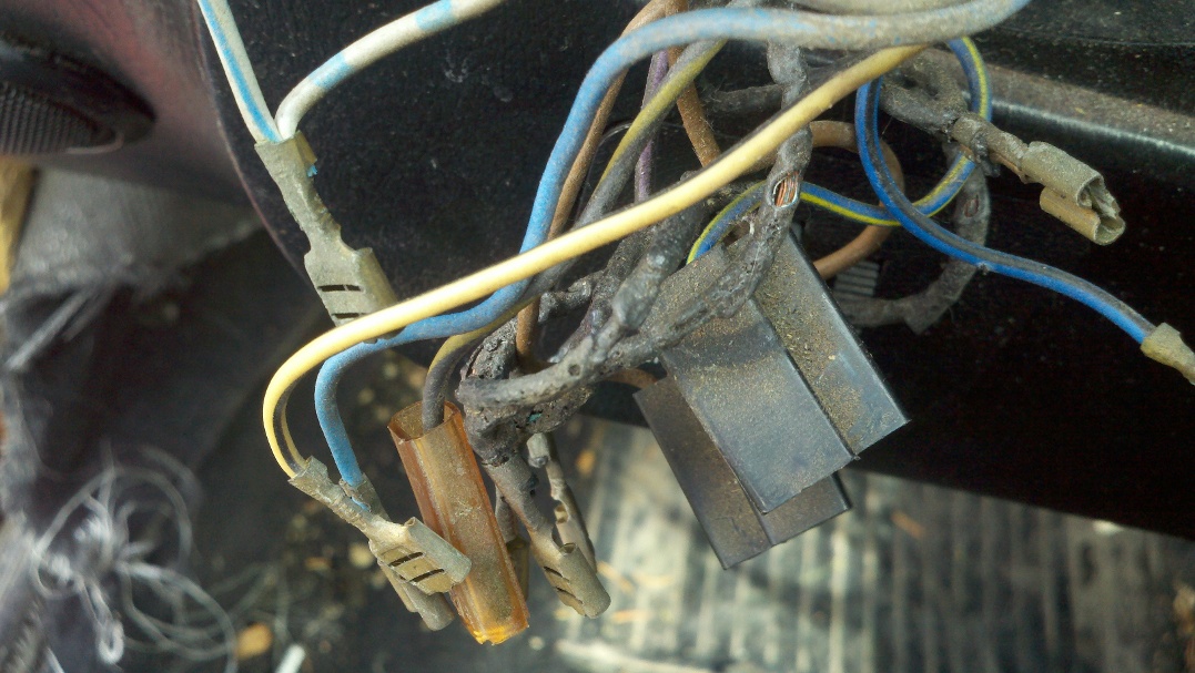

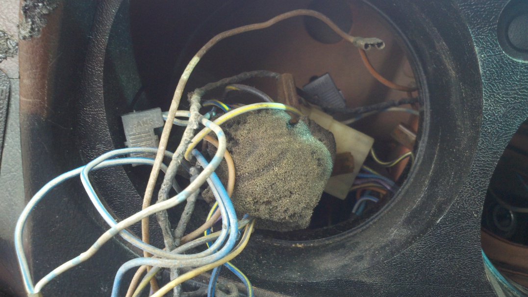

One of the things that I noticed when I picked up my 924.... is that none of the illumination worked for any part of the dashboard. I decided to pull the gauges today (partially to check the bulbs and also to check look in to making some digital gauges). Below is what I found... a nice tangle of melted wire. It appears that the illumination power wire as a whole is bubbled and crispy... and a few other wires are similar but not as bad. Oh wells, good things I was planning on doing a re-wire anyway!

Thats no fun ive had it happen to me once a long time ago
..it just kind of smoked out the dash. Too much smoke.

Someone may have put the wrong lamps in the cluster, trying to get more illumination on the gauge. Drew too many amps and melted things maybe?
