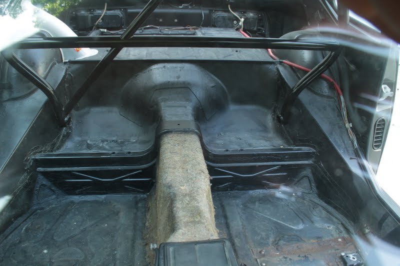

From my Club Sport thread. Bear in mind, the carpet piece for the rear foot well area will be re-installed. But these pix will illustrate what I described above. Everything in the back is a bit dusty, but when I wipe it down, the flat black hides all of the imperfections quite nicely.
Rear seat delete & hatch strip down
Detail of headliner pieces from 924S

This might be a stupid question but since you have it installed you will know. Will that bar withstand a roll-over , as it is, do you think it would need flat plates to withstand a roll-over.
It looks as if it might go thru the local ICC regulations which states that at least a roll over bar which protects the drivers head must be fitted.
AH yes your interior looks very similar to MAX's interior, I can even note that you also didnt remove the sound deadening fromt the centre tunnel as I did.
That bar though gives it a different racy look. I think I would start putting a list together on my notebook for the interior .
BTW you mentioned track pads which im not sure what you meant by, can you elaborate on what these look like, are they like chequered plates which attache on the inner firewall side? Iv seen these somewhere and like them too.

Since the bar is attached to the C-pillars and the very strong, reinforced section where the lower seatbelts attach, I would expect it to provide some rollover protection...but it was never intended to take the place of a full cage. What it will do is add some stiffness to the rear of the car, and also provide mounting points for the six point harnesses I will be using. Since the car is intended to be a "club racer", I did not want a full cage in it due to cost and ease of ingress / exit. The bar I selected is a compromise between the simple harness bars that bolt to the less-strong B-pillar points, and the half-cage that went into the 968 and 937GTS club racers.
RE: the deadening material on the tunnel, I left it there out of laziness: the few extra pounds of weight reduction were not worth the mess and effort required to remove it. The UWB project is a different story...
RE: track mats, this is what I had in mind:
