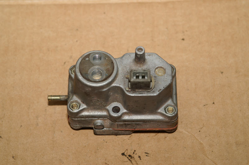

Ideola, To clarify - in the picture of the 931 WUR you posted, is the side connection the Vac connection and the top one is open to atmosphere? Or do they both get hooked up somehow? My car has neither.
PostPosted: Fri Aug 06, 2010 4:42 am    Post subject: Reply with quote
The side connection is the vacuum/boost port, and the top one is open to atmosphere.
