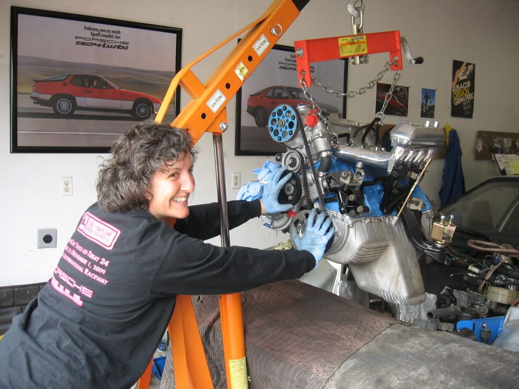

I dunno, mine's with the program:
Besides your wife being pretty and congrats to her for sharing the work with you, id like to comment on that clean tidy engine shes handling, My eye went particularly on the inlet. throttle manifold, Dont tell me she polished it herself, cause i might be tempted to hand over the 924 valve cover to my wife, btw I might even show this pic to mine, maybe she will have a change of heart and start getting her hands dirty
