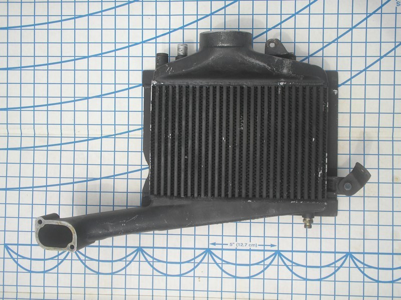

Who has em. Supposedly Zuffen had posted them but I am unable to come up with them. I searched and came up empty handed. I know there are some photos available here somewhere.... Anyone?

Here are some photos I took with the intercooler/engine before I installed it in Spike:
PostPosted: Fri Jan 29, 2010 6:52 am    Post subject: Reply with quote
Maybe you were thinking of these (click to go to the album):
PostPosted: Fri Jan 29, 2010 7:32 am    Post subject: Reply with quote
Those pics are enjoyable to look at, they dont get me hard or anything though close. I saved them to my drive.

So the core itself is roughly 8x12x3?
Yes, roughly. From the one I held in my hands when visiting BoostFeen a few years back, I believe the core is actually something like 2.75" thick.
It does measure 8"x12"x2"
To to exact, its a bar-plate type of IC:
There are 25 bars that are 200mm long.
Every bar is 4mm wide and 48mm high measured on the inside.
The aluminium is 1mm thick.
The frontarea is similar to the 951 core, 8"x12" vs 5"x18".
The internal chargearea is also similar, 2"x12" vs 5"x5"
