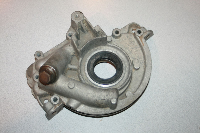

What bolts on here? (see pic)
PostPosted: Thu Jan 07, 2010 9:18 am    Post subject: What bolts on here? (see pic) Reply with quote
What we have here, boys and girl(s), is a standard issue 924 / 931 oil pump housing. What I'm wanting to know is whether there is anything that is supposed to be bolted into that threaded hole in roughly the 12:00 position in this photograph, the large, overhanging boss just above the TDC pointer. The only car I have for reference doesn't have anything there, but I don't want to make an assumption based on one car. Also, I don't see anything in PET. Does anybody know if there's supposed to be something bolted there?

PostPosted: Thu Jan 07, 2010 9:36 am    Post subject: Reply with quote
What year is it from? I could have sworn i have an oil cooler that hangs off something like that on the late model engine i'm rebuilding, i'll look when i get home.

PostPosted: Thu Jan 07, 2010 9:40 am    Post subject: Reply with quote
I have nothing there... What does the back look like??? I am curious now, I was able to stick my fingure tip inside the back side of that boss. Its close to the cam belt, what would possibly go there? I have no cover... Does the cam belt cover attach there???

PostPosted: Thu Jan 07, 2010 9:41 am    Post subject: Reply with quote
I don't know what year this one is specifically from, but the oil pump is identical across the entire 2.0L lineup as far as I know. My reference car is a 1980 931 with a 1981 engine
I'm not sure what you mean by oil cooler, because there wasn't one on the NAs, and on the 931, it's mounted under the RHS headlight. There's not room in that location anyway for anything that large because both sides of the cam belt pass within an inch of that boss.
PostPosted: Thu Jan 07, 2010 9:44 am    Post subject: Reply with quote
Ding ding ding ding ding! We have a winner!
D'oh. OK. Back to the drawing board. Thanks!
