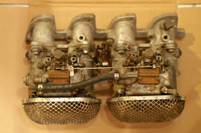

At one time I was considering a carb swap on my NA, and during that evaluation process, I purchased both a Weber setup and a Dellorto setup. I sold both of them, and DOCO has a pretty good thread going on his conversion using the Weber setup he bought from me.
http://www.924board.org/viewtopic.php?t=28886
The guy who bought my Dellortos hasn't been around much, so I don't know how far along he might be.
Dellortos:
http://lh6.ggpht.com/__pqkhEfdq8I/SNB8OQ4oW7I/AAAAAAAAFso/sUgX7Zwja90/s400/PICT0799.JPG
Webers:
http://lh3.ggpht.com/__pqkhEfdq8I/SNB8PHi2osI/AAAAAAAAFsw/GF4xiY6GQTU/s400/PICT0800.JPG
Dellortos:
Webers:
