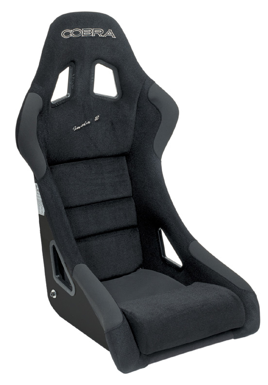

i tried some of the cheaper steel fram seats, its not something i recomend, not at all. Add some bucks and buy a fiber glass chair. I found that Cobra Imola S suited me really nice. I did mountings according to the racing regulations and put it on the stock sliding mounts, really neat. It really adds a new dimension to driving, at least if you drive at the track or auto cross. After i added a OMP lower back pillow it worked nice even for longer trips. If you choose a seat that isnt that extreme, with other words has lower sides it works ok with stock belt.
Why not adda picture of my setup
