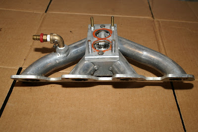

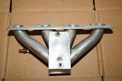

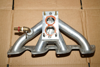

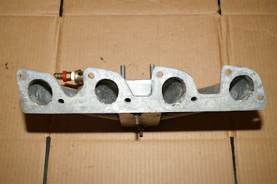

Photos of carb conversions:
Dual Dellorto
Dual Weber 40DCOE
Custom manifold for single carb setup
I don't know what kind of carb was being used on this last setup, I only have the manifold.

The single carb manifold is available for sale, listed here for $50. I do NOT have the carb for it, it is only the manifold. I cannot attest to its air-tightness or provenance, as it came to me in a "lot" with a bunch of other 924 parts. It is setup for a 1976-1982 924 NA. Shoot me a PM with your email address and info if you're interested.
