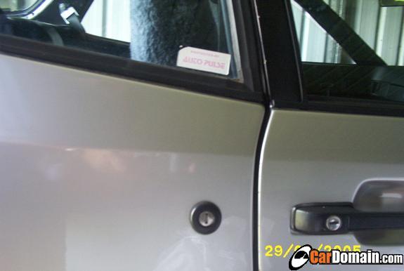

1. There is a hole in the RH (drivers) rear 1/4 panel, it is about 20mm diameter, just behind the fuel filler. Any ideas what it's for?

1) You mean on the outside?? No idea. I did see some pics of a factory alarm with external keyed operation, but I think it was situated at the front of the rear qtr panel (ie below and to the right of the filler).

Yep, the hole is in the body, it is rearward of the fuel filler.

My only guess on the hole is an alarm key, but it's in a different spot to where I saw the factory option... Should be easy enough to fill. I'm trying to find the info on the alarm, but I can't at the moment...
PostPosted: Sun Jan 20, 2008 5:53 pm    Post subject: Reply with quote
I think this is the factory option:
