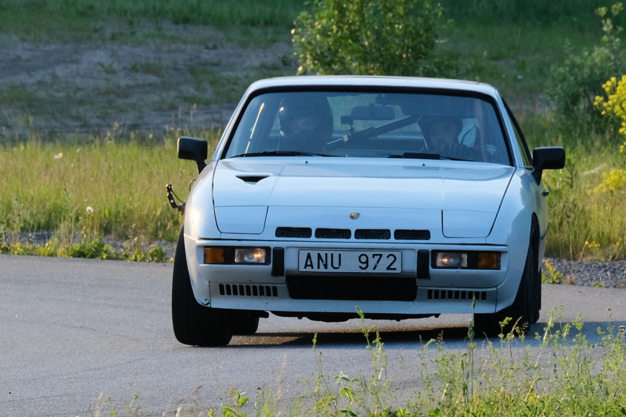

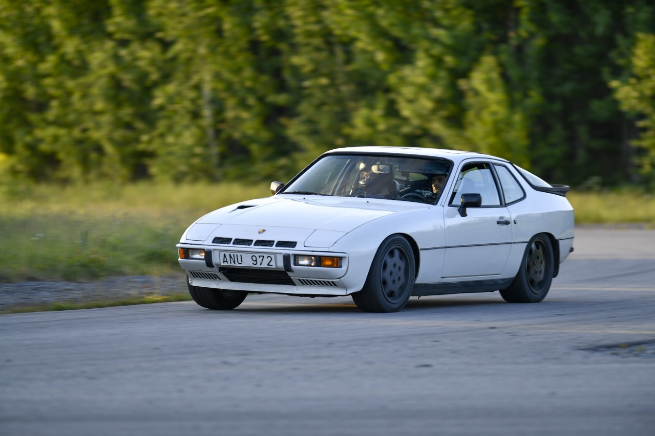

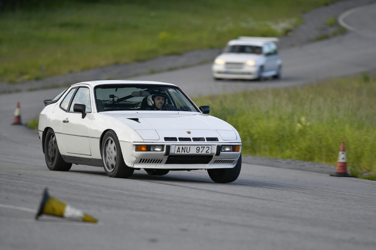

Some photos from this winter, other than the wilwood rears. Found a cracked seat mount that needed welding, also fit a new OMP dual locking seat rail which fixed the very annoying slop of the original one, so much better.
Had a track day aswell to try everything out, hopefully some video coming out aswell. really fun to hammer it again, its really when the car really shines Im still adjusting to the brakes, the high friction pads I chose and stiffer calipers do take some adjusting to not lock up everywhere. After so many years it takes a while to readjust, but in the end of the day it started to work out really well, when i let them warm up before going hard, the bite and feel is very very good now! (DS3.12 front and EBC RP-X back). The GAZ golds are also working really well, very comfy for the road driving, and good control on track. Will put on my stiffer springs sometime, it needs it
Everything held up great, bolt got loose to the right camber adjustment which made camber very dymanic as seen on the videos afterwards (and on the pics below), Im going back to factory bolt there, have those on the left and they hold up just fine, much better designed.
