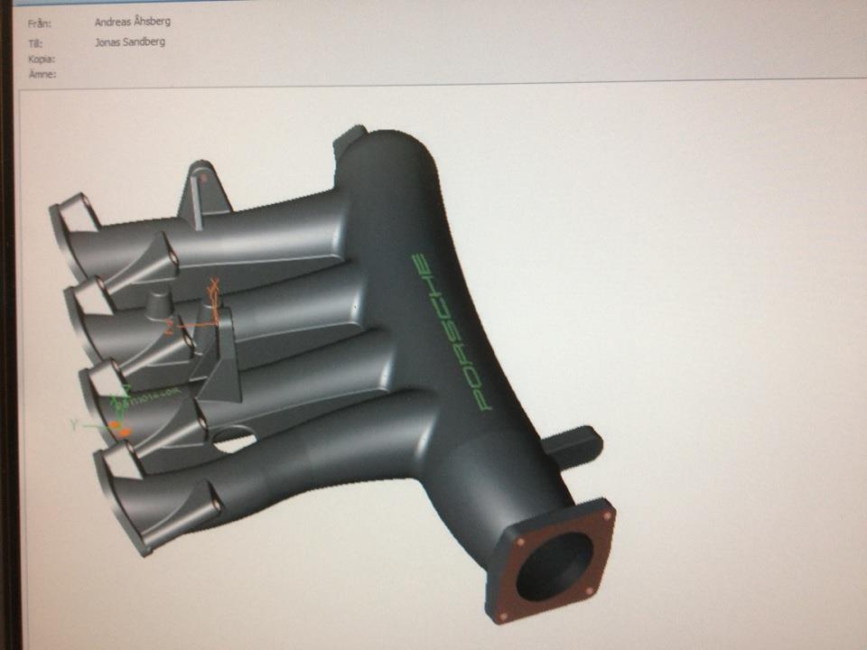

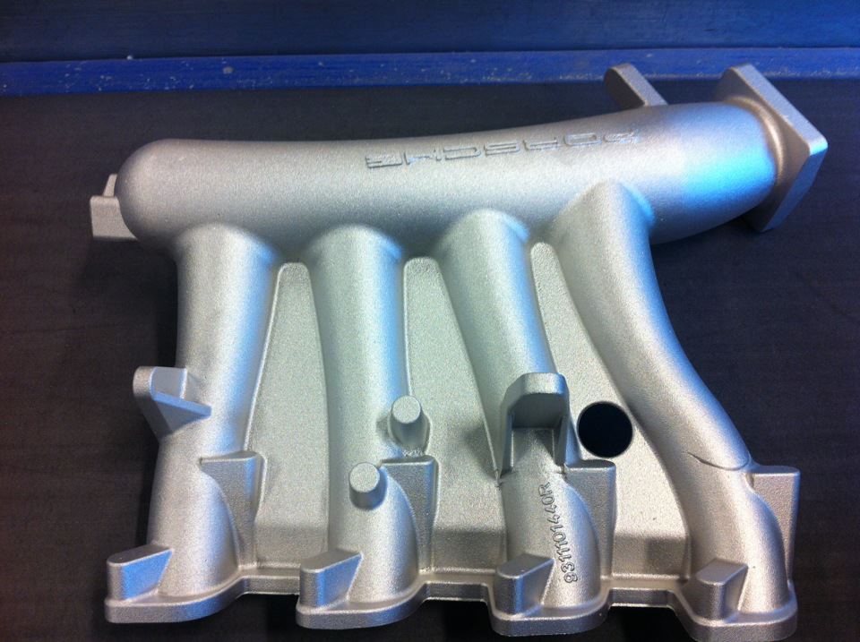

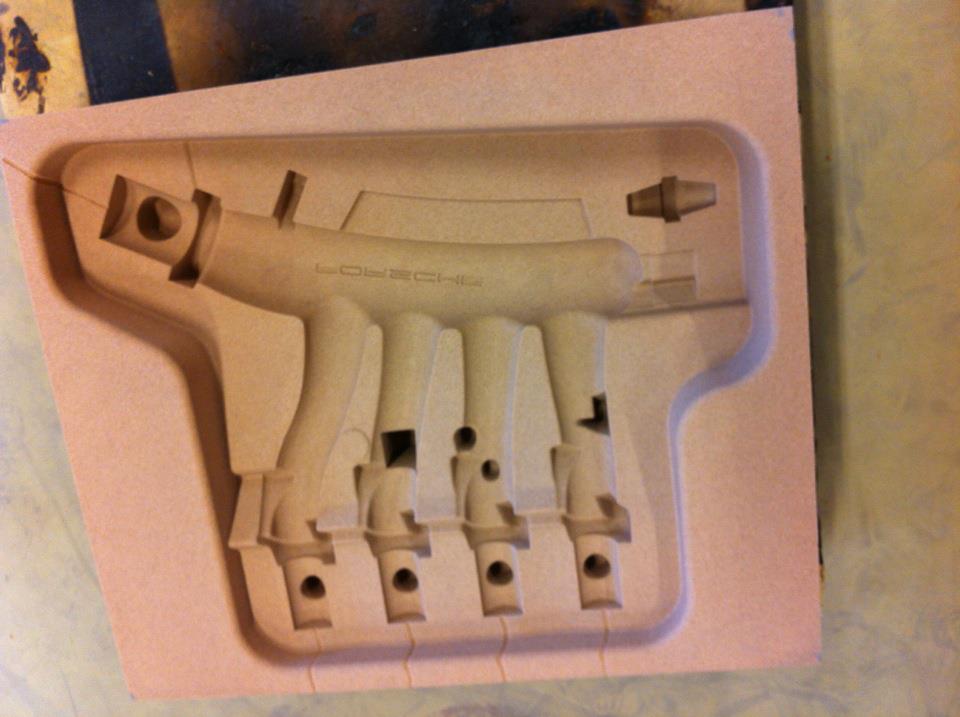

Maybe you should have a talk with the guy that recreated and cast all the GTS specific parts for his rally car, it was cheaper than buying them from germany. I can send you his contact details if you want, see some pics from the process.
Im not sure how Simon thoughts were going there, maybe he machines it larger than its possible to do with the 951 housing, im not sure. The 951 is pressure die cast so very light and thin.

Oh btw, could you measure the GTS inlet length if you have time? Good reference data to have to understand their intentions.
Heres a pic from my intercooler thread:
