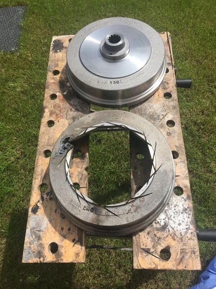

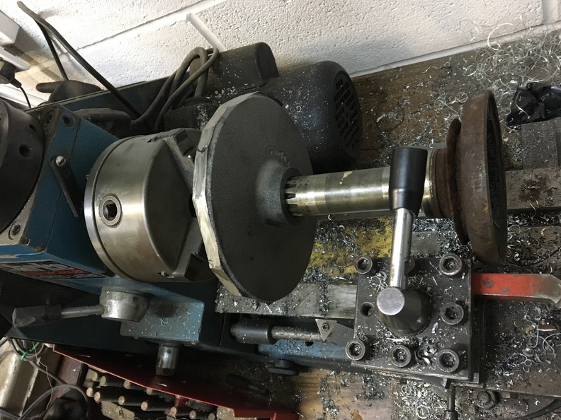

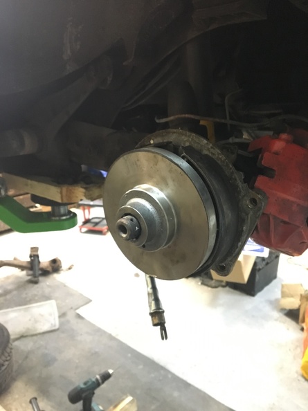

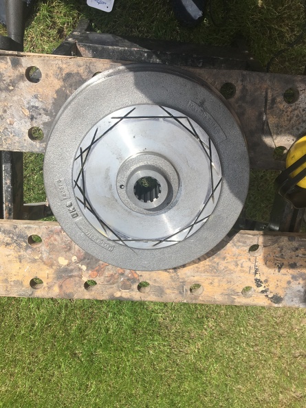

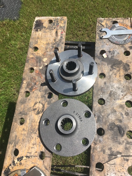

Have been a little bit lazy. For anyone interested, heres the photos John sent me of how he converted the rear drum to disc hub.
May be of help to someone. I ended up getting my hands on a full set of 5 stud hubs....wallet is still recovering [the freight was more expensive than the bloody hubs!]

Cheers guys. Worth noting that these blank drums came from www.machine7.co.uk in the UK. They do a 5x130 Porsche PCD off the shelf, but these are drilled to 5x114.3 which is popular Jap car (Mitsubishi, Toyota etc) pattern so they will fit my forged SSR wheels. Clearly not many folk fit Jap wheels to their beetles so they don’t cater for that PCD off the shelf.
The challenge once you’ve made the hubs is then finding a disc which will work with your calipers and brake shoes (if running a drum type handbrake).
