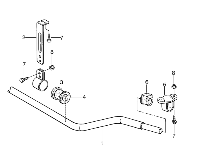

| Juho wrote: | but my 944s sway bar has a different type of mounting to controll arm
Old vs new.
Your style is pre~1981 |
Juho
Joined: 03 Oct 2018 Posts: 392 Location: Finland
Posted: Wed Feb 03, 2021 8:37 am Post subject: Re: 1 stud build |
| Harm wrote: | ^Those won't fit.
You need the common VW Golf Mk1 part (McPherson suspension)
Make sure it includes holes to connect the sway bar.
The other parts you'll need shown here…
my car is 85 and the control arms look like that |
safe
Joined: 18 Mar 2017 Posts: 698 Location: Sweden
Posted: Wed Feb 03, 2021 8:41 am Post subject: |
The bar and body mounts are the same, you need the early 944 outer mounts to the steel arms.
1986, I think, the 944 got aluminum arms and in 87 the changed them again to a higher offset.
You have to check the PET for part numbers to se what changed during the years and models and compare them to figure out what you need and what will fit together. _________________ /Magnus, Stockholm Sweden
Porsche 924 -79 NA, EFI and Turbo.
Porsche 931 -79
Porsche 911 -77, 3.2 Targa
Porsche 911 -69, 3.6, Coupe |
Juho
Posted: Wed Feb 03, 2021 8:55 am Post subject: Re: 1 stud build |
i dont think i need new arms or mounts because my looks exactly like this atm |
Harm
Joined: 02 Apr 2009 Posts: 1376 Location: Holland
Posted: Wed Feb 03, 2021 9:19 am Post subject: Re: 1 stud build |
1985 and drop links doesn't compute in my book.
If your chassis has the old style sway bar that uses the drop links,
I wouldn't recommend switching to the 944 style (1982+)
It could damage the chassis when it is not put together decent. |
Juho
Posted: Wed Feb 03, 2021 9:41 am Post subject: |
Im sorry if im missing something but there arent drop links right? This is how my old sway bar looks llike |
Harm
Posted: Wed Feb 03, 2021 8:09 pm Post subject: Re: 1 stud build |
| The only drop links or sway bar links you'll have are connected to the rear sway bar. |
Juho
Posted: Wed Feb 03, 2021 10:08 pm Post subject: |
llooks like i dont have rear sway bar at allll, explains why the car handles like it does
i thought all euro cars came with one |
