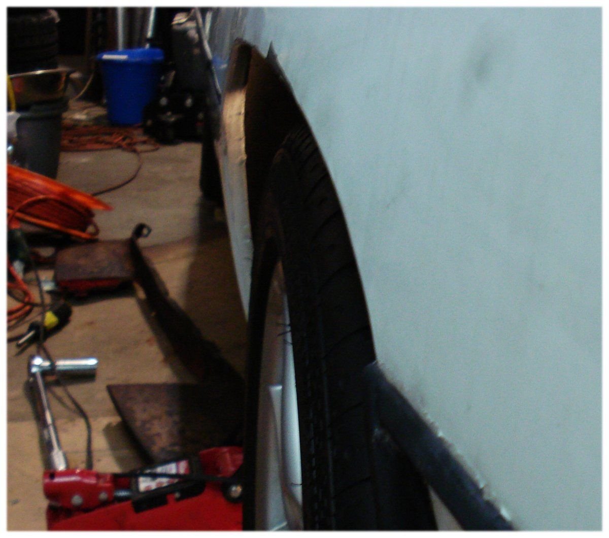

So I test fitted some 996 wheels which were 17x9 with 255/40 tires on them...
they almost fit! I removed the factory 21mm spacer, but had to used some 2mm washers to get the nuts to tighten.
Ill post some pics below, just to note, I think I could use a 5-8mm spacer and that would help the tire clear the nuts on the trailing arm.
I was planning on using 245/40 tires[/img]

PostPosted: Tue Nov 03, 2020 3:17 pm    Post subject: Reply with quote
more pictures of clearance, how much further can it be spaced out?

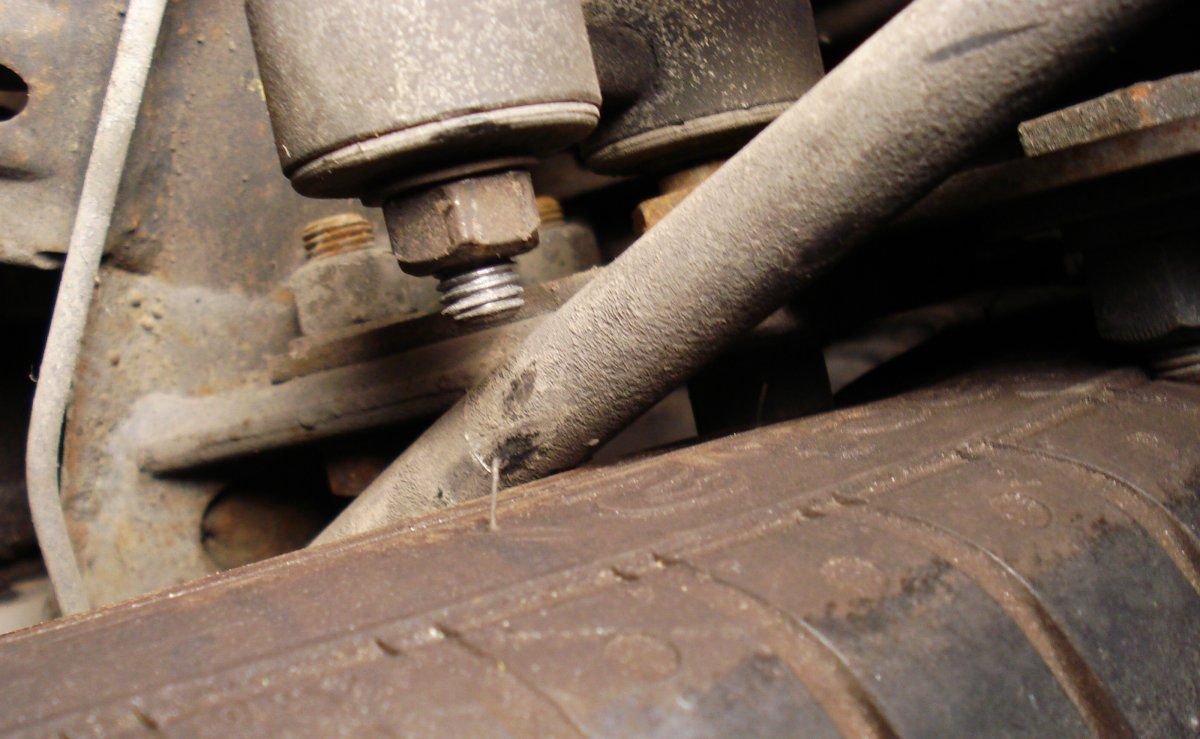

PostPosted: Tue Nov 03, 2020 3:19 pm    Post subject: Reply with quote
problem is on the inside you can see it hitting the bolts here (again this is a 255 tire)

PostPosted: Tue Nov 03, 2020 3:41 pm    Post subject: Reply with quote
Shave the bolt down to the nuts for a start. Then get some m14 washers and experiment.
You can have 6-7mm before you need longera studs or go to a bolted spacer but those need to be about 18mm to be strong enough, assuming the wheels have clearence on the inside between the bolts.
