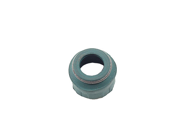

Definitely a valve stem seal...was my first thought before reading thru the thread when you mentioned the thin metal ring...maybe the spring retainer of the stem seal:

I found some original valve seals and it looks very much like the pieces.
