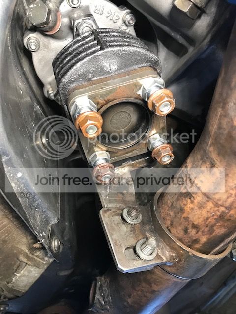

Spent some time under the car today. I was able to get everything back together...except the starter.
Earlier I had noticed that the clutch slave cylinder was leaking. It continued to leak as I worked on the car. At one point I pushed in the clutch and it went to the floor..followed by even more leakage. So will troubleshoot that next. I think it's the slave cylinder and I've read the suggestion to replace the master and slave at the same time. So will read up on that.
Here is the process I used to reassemble everything:
1. Reassemble wastegate - It's very important have the bracket in the right place. I also was very concerned that the diaphragm would slip out of the groove at the bottom....so I held it down tightly and started three nuts in a triangle pattern to make sure it stays in place while fighting again the spring. I tightened the nuts in a star pattern as if tightening lug nuts. I checked the valve operation (like 20 times) with my Ryobi air compressor which generates just enough pressure to open the valve about 3/4 of the way; this will be important later on. Not the most exciting video, but this is what it does https://youtu.be/qg84Pz54Lqw with this small compressor. I used the larger compressor, but with the pressure turned way down. WG seems to be working as expected.
2. Install WG - This wasn't too difficult but a bit tricky given the amount of adjustment in the bracket. How high or how low should it be mounted? I connected the rigid boost control line figuring that would be a good yardstick...then tightened the bolts for the bracket. I reinstalled the heat shield. With that installed it's really difficult to get to the bracket/nuts should further adjustment be needed. So hopefully I guessed right on how the WG should be mounted.
Note: the steel nuts in the picture below are there temporarily to keep the valve seat from flopping around.
It took a while to get to this point but happy to have the WG off the workbench and back in the car.
3. Install exhaust from turbo to cat converter. This took a while and I learned some things along the way. Critically important is to install the bypass pipe with the rest of the exhaust at the same time. I didn't the first time around. Had to loosen the connection at the turbo to move everything back an inch in order to install the bypass pipe and line it up with the WG connection.
Again, gravity is important. The exhaust section is heavy. I used a series of bungee cords to suspend it as I was connecting everything.
4. Connecting the exhaust to the turbo. This is really part of the step above, but I found it to be more involved. I couldn't one of the nuts started with the exhaust up against the turbo. ...had to loosen everything (again), pull it back 1/4in, start the nut...then push everything back into place. That wasn't mention in the Haynes manual. "installation is the reserve of the removal procedure." lol. I kept saying that to myself today.
And maybe this stud was just a bit too long. Circled in yellow below.
5. At this point I decided not to install the muffler. I figured if I had to back track I wouldn't want to remove that again...so decided to install the muffler last (well, before the starter at least).
6. Install the J pipe. This is tricky. The valve seat is being pushed down by the valve (and the spring behind it). When I held the J pipe up to install it, it was like 1/2 inch from the bottom of the exhaust manifold. I read elsewhere that tightening the nuts would push the valve seat in...and push the valve up. That's a lot to ask from 12 mm copper nuts. So....and I thought this was clever....I reattached my Ryobi air compressor to the boost control line where it attaches to the intake. I had my wife/assistant operate the Ryobi with me under the car. As the pressure built the valve opened up as shown in the YouTube video....and I was easily able to install the four 12mm nuts at the bottom of the WG.....and the J pipe was a lot closer to the exhaust manifold.
Here is the bottom of the WG again. With help from the Ryobi, the valve seat could move up about a 1/4'...and the nuts could be tightened at that point. (I did remove the steel nuts).
Here is the after photo:
Connecting the J pipe to the exhaust manifold required a long extension between the exhaust and J pipe and some stretching my part.
7. Install final muffler - This took a bit longer than expected. The muffler and pipe is heavy and awkward. Again I rigged up bungees to suspend the muffler. I think next time I might use milk crates. Anyway at the rear the muffler is connected by a huge oval clamp. At the front the muffler is connected to the exhaust with four bolts and is attached to the car with a rubber hanger. I attached the hanger first, then worked on the four bolts.
Next step will be to diagnose the problem with the clutch slave cylinder...I think it needs to be replaced but will read up on that.
One other note...I don't think a TiAL 46 mm would be a direct replacement. It appears that the WG is also supporting at least some of the weight of the exhaust. I'll post pictures to illustrate the point, but to me it seems like an additional bracket of some sort would need to connect from the bypass pipe to the underside of the car to provide support.
If this WG doesn't work out, that's where I am headed next. But hopefully not.

As I've read about the 930/931 WG, many times the vent at the top is mentioned but I never found any pictures without it being attached.
It's nothing fancy but here's what it looks like for future reference.
and now upside down...seems a bit over engineered....
