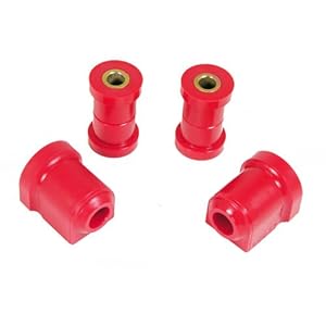

Pro-thane 22-201 about $25-30 from various vendors:
http://www.amazon.com/Prothane-22-201-Front-Control-Bushing/dp/B003876ST4
Has the proper metal inserts.

PostPosted: Wed Aug 10, 2011 6:58 am    Post subject: Reply with quote
I really wished i had seen those sooner.

PostPosted: Wed Aug 10, 2011 8:51 am    Post subject: Reply with quote
I just put these on my car and it made installing sooooooo much easier, highly recommended. Sucks you had to go through it.
