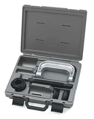

We were able to remove the cotter pin and castle nut and get it to pop with a pickle fork. Now we just can't get the ball joint to press out. The "receiver" parts, in the bottom left of picture, are "well used" and don't stay when tightening the press. The press used is here:
