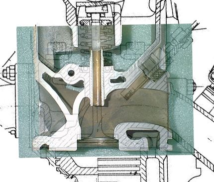

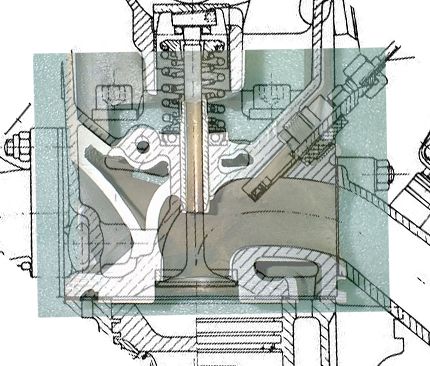

PostPosted: Tue Jul 07, 2009 3:11 am    Post subject: Reply with quote
Comparing to endwrench's sectioned NA head:
(80% transparency on the left, 60% transparency on the right)

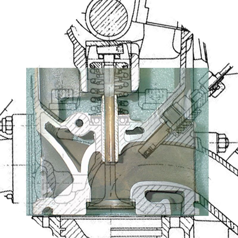

Another attempt to do the superimposition a bit more precisely...70% transparency...also, up-sampled the image to 800x800 pixels:
