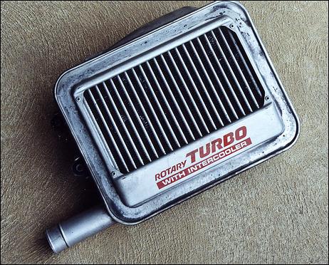

Dave, the intercooler from the RX7 is the one to go for. I just sold one yesterday (needed the cash for other things).
The best RX7 one is from the series 4 (second best is the series 5). It will fit easily in the nose. You could also top-mount one, they're top-mounted in the RX7.
The actual size of the S4 'cooler is 370mm wide (not counting the pipes which can be cut off and rewelded if needed) 320mm high and 80mm deep and the end-tank pipes are 48mm ID.

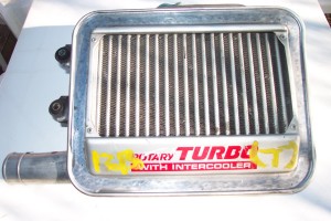

To clarify, the series 4 is the FC3S Turbo 2, right? In other words, second gen RX7, 88-91?
Posts: 2743
PostPosted: Sun Jul 21, 2002 9:17 pm    Post subject: Reply with quote
it's the one that looks like
The series 5 one looks like
The trick to telling the difference between the two is to measure the header pipes. On the S4 the pipes are both 48mm Inner Diameter and on the S5 one pipe is 48mm ID and the other is only 40mm.
Either is good it's just that the S4 is better. Of course, if you cut the end tanks off and add custom ones then as far as I know there is no difference in the cores. As for when the different RX7s came out, I have no idea. I prefer the original to the Japanese copy
