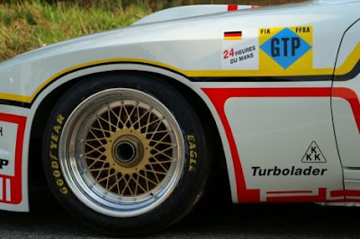

Rob the plumber wrote:
In my opinion, the only wheels that look good in body color are the BBS deep dished basket weave (NOT the stock 924 basket weaves).
They look kinda like the 80's GTA Trans Am wheels?
Like these:
Personally, I don't care for the Fuchs painted body color:

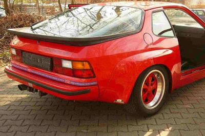

This is just what MY car looks like!
Glad you liked it!
Centers will be black later this year...
