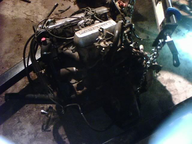

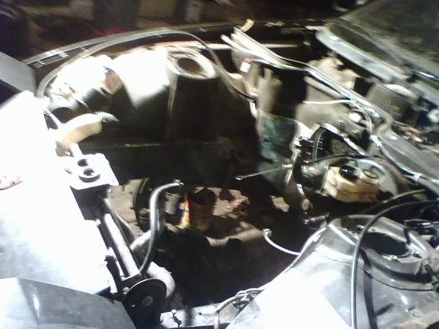

I wish I could do so, but Ive already gotten myself so deep into this there is no recovery for the money Ive shelled out, only joy when it is finished. Once I bought the 924, I saw a 85 944 for sale nearby but they wanted far too much than I could afford. Since then Ive looked for a 944 (while looking for a pickup lol) and havent seen but the one in detroit. Im going to finish this conversion like I planned, and try to get the engine and drivetrain in before spring so I can at least drive it.
Here are some pics taken with my cell phone a few weeks ago. Sorry if a few are blurry, detail sucks too but better than nothing I say. I need to take some more now since the progress has increased.
Engine is still in, almost ready to pull out.
Cute little thing isnt it?
Fender came off for more easy access.
Tadahhhh, no poor beaten up 160k+ 2.0 anymore.
OH BTW! all of the old parts will be going up for sale shortly when I get time to post again.
